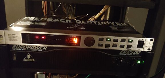

Well I really don't know what is going on. I am posting 4 measurements that I took this morning with the Umik1. Two of them are without any filters but at different levels and the other 2 at same levels with the BFD in the picture. Remember, I am a noob at this and this is a sub I built to listen to music in my HT as well as watch movies. Only the sub was working when I took the measurements and I can't even tell by the graphs if this sub is half decent. I will try to post a picture of the BFD in standby meaning no music is input. The only difference when playing music is the far left green led's are jumping around.

I just had a brain fart. I have been inputting all my frequencies into 1 channel only be it 4 or 5 and storing them there. Now since I want to use this as parametric eq, should I only input 1 frequency per channel, store that and move on to the next?

About the only “gotchas” I remember is that it has to be set for parametric EQ. I don’t recall if both channels can be programmed separately, but I’m sure they can.
I also remember some kind of “x10” multiplier that had to be set correctly. A common problem would be that people thought they were adjusting 60 Hz, but were in reality adjusting 600 Hz. If you’re not hearing a difference switching it in and out, that might be the problem.

I wrote Behringer today, well actually musictribe.com. It seems there was an update to keep this exact same thing from happening. I don't know if I need the update since I can't tell what software version I have. Hopefully, they will help me. As for the X10 multiplier, that starts at 200 Hz since it reads .20 KHz. I tried everything so far, always set on parametric EQ and nothing seems to work. Thinking of getting a minidsp. I will wait and see what musictribe has to say.
