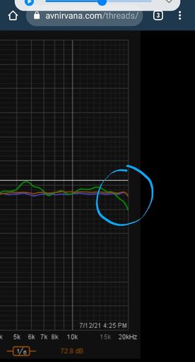

My processor Anthem AVM70, has ARC which by default EQs till 5KHz. After reading posts that said EQing past 500Hz was bad, I tried to limit ARC to 500Hz. The difference was very noticeable. I then tried to EQ up to 10KHz and didn't hear much of a difference between the 5KHz and 10KHz limits. I currently use the default 5KHz limit and am happy with the sound.

AVA ABX
You referenced not having the Revel graph
We now have the Revel LP "corrected" and uncorrected. Now all we need is the "speaker" data. 1.5m +/-, 0,45 off axis uncorrected and corrected to see what is "correct". I think by now it's pretty clear you didn't do a (c) like the "experts" did above. That's ok, (a) and (b) will suffice. I've found anechoic data for that model so we'll see.
AJ Soundfield

AVA ABX
It is likely that most people of any given age would prefer the corrected response over the uncorrected.
I wouldn't project that from a sample of 3 people using 3-4 speakers in Sonnie's room. It certainly appears under such conditions the EQ'd speakers were preferred. With no reference yet, I'll say "EQ'd", not "corrected".
There is no "Old Guy Hearing Acuity EQ Compensation" setting on Dirac.
With no "speaker" responses, the first 2 graphs posted certainly suggested so.:)
I'll say "corrected", because Dirac does much more than EQ.
If what you are suggesting about hearing acuity were true, we'd see an unnatural rise above 10kHz at the LP, not the corrected flat response we see with each speaker. Dirac doesn't give us a v-shape at the LP.

The point being... whatever Dirac did, it "improved" the sound at least slightly enough for preference, but it didn't kick the other option to the curb either.
We certainly aren't talking huge waves here, but preference does matter, even if it's minor. There are those that like to seek out every last drop of improvement.
