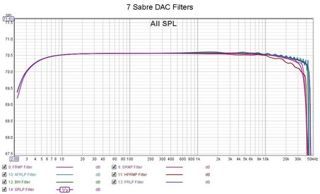

FWIW, I measured the 7 Sabre DAC filters on my DAC using 48, 96 and 192KHz sample rates using a hardware loopback which measured the sound card, PC and DAC only (no amp, speakers or room interactions).
The FRLP (Fast Rolloff Linear Phase) filter had the widest, flattest frequency amplitude and phase responses of the 7 filters.
My take-away from that observation is that the FRLP filter would be the easiest to modify because it would require the least amount of modifications (sans the speaker and room interactions which are of much larger scale). YMMV.
NOTE: Scale is from [2 - 50,000]Hz, SPL divisions are 0.1dB, no smoothing.
FRLP measured at 48, 96 and 192KHz.
Note: Scale is [2 - 100,000]Hz, SPL divisions are 1dB, no smoothing.
