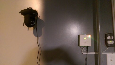

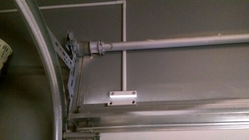

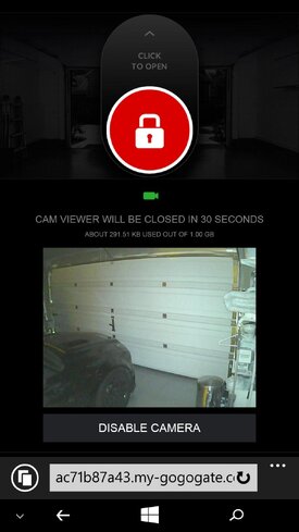

So I am currently using Gogogate with a wireless foscam PTZ camera (FI8910W) inside my garage to operate the garage and record every time it opens or shuts. I can access it through a foscam app on my phone. Photo 5 shows the gogogate app open on the phone. Photo 6 shows the Gogogate and wireless foscam PTZ in garage. Photo 7 shows the hardwire gogogate garage sensor. You wire the gogogate module to the push button garage door opener. You wire the gogogate door sensor to the gogogate module and then run and place the sensor on garage door. Electrical plug in the gogogate module. Install wireless camera and setup. Input camera ip into gogogate setup.

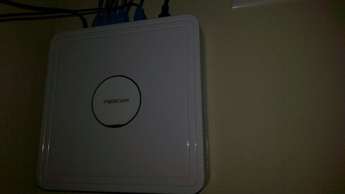

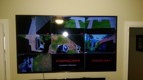

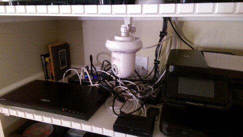

I have the foscam DVR and 8 720P POE cameras (FN3108XE-B8-2T) around the house perimeter. The DVR is mounted in my master closet and hdmi to my tv in the master bedroom. Photo 1 is the DVR in closet. Photo 2 is the DVR footage hdmi to my tv in bedroom.

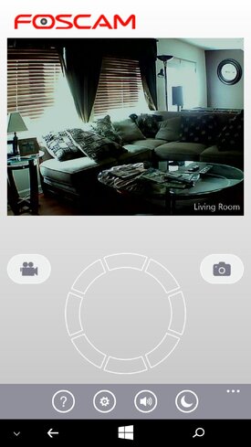

I have a foscam PTZ camera over Ethernet ( FI8910E) on the main floor ( open floor plan) Photo 8. I can access it also through a foscam app on my phone. Photo 9 shows the foscam app open.

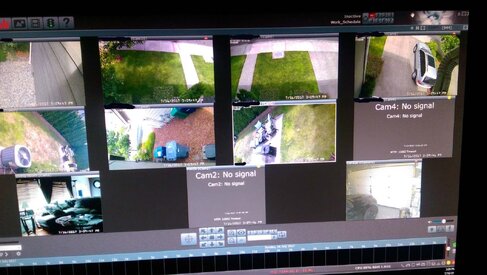

All my camera feeds are loaded in blue iris and can be viewed by TV's throughout my house or through the blue iris app on my phone. Photo 3 below.

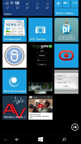

Photo 4 shows the gogogate app/ foscam app/ blue iris app on phone tile from left to right.
As you will notice on some screen shots two of my cameras are currently down. The one on my porch is down due to an electrical issue with the porch outlet. I am currently looking into a means to run cat5 and install a POE camera for greater reliability and as I am yet to look into re-wiring the outlet. I will clearly state that the wireless cameras will drop connection occasionally, when this happens you are not able to always reboot remotely. A lot of the time you need to physically unplug them and re-plug them in to an electrical source to get them to cycle. One of the reason I will eventually replace the wireless cams with POE. One of the cameras in the back yard is down as I removed it when I was recently painting the house. One of these days I will get around to re-installing it. You know how it is with the to do lists....:olddude:

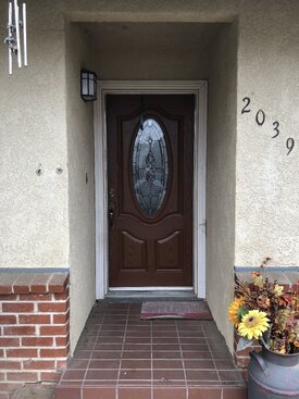

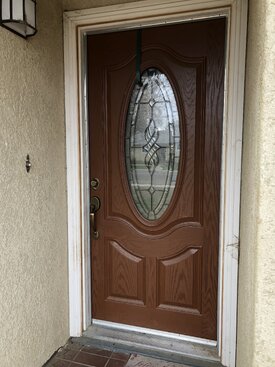

So, I haven't bought any surveillance cameras yet since things haven't been stolen from our home anymore. However, lately there has been someone at night ringing the bell for no apparent reason. It doesn't happen all the time, but when it does is while I am at work.
I was thinking of giving the Ring a try, but I am not sure about two things:
1) The location where my current door bell is located is probably not the best location for the Ring. I know the ring can be use with its battery, but I think possibly relocating the cable to go to the door frame would be best? What do you guys think? I am including a picture of the front door area so you can see what I am talking about.
2) The cost? I guess Ring only gives you 1 year of free recording and thereafter you have to pay $100 a year for their full service. Is this worth it?
P.S. Please do not mind the dirt and spider webs on the front door.
