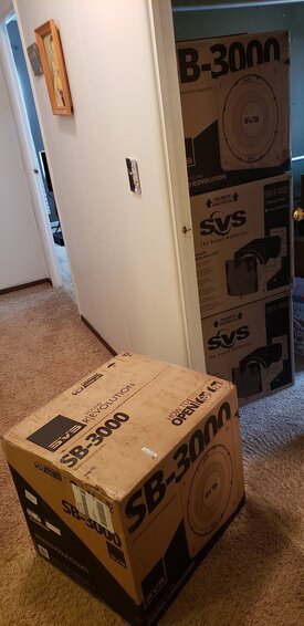

My brother-in-law once said "donde come uno comen dos, donde comen dos comen tres...": mistranslation: you NEED four. :T
Why send them to me, of course, to reduce clutter. Glad to help!
Or you could keep them and integrate four subs...yowza!
Yeah, I got a little clutter going on, lol. Only one of these boxes, the SB-3k box stacked topmost in the office room, is empty. I could run 4 subs, yes. :)

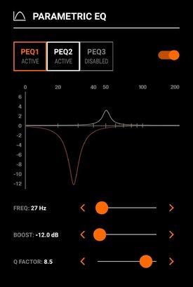

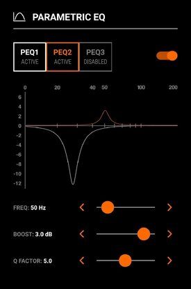

Been playing around with placement/settings for a couple of weeks. Ended up here, with the left sub phase set at 70 degrees, right at 0, a sharp, high Q PEQ cut centered around 27 Hz and a medium Q 3 dB boost centered around 50 Hz. That was a lot of work, sorting out the problems in this tiny room. Work still remains, but I now have somewhat of a handle on this capabilities and limitations of this new room.
Goosebumps happened tonight. Confident that not much more can be done at this point, I did some cable management, as the positioning is settled, for now.

41468
SVS app screenshots...
