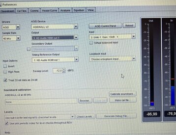

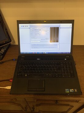

Hello,
I have a Dell Win 10 64bit Laptop with HDMI Output onboard.
The miniDSP Micro is connected via USB, REW recognizes and works.
HDMI to Marantz - does it work? I do not get it run in REW.
I connect the HDMI cable, Win makes the jingle, Marantz is not doing anything, REW does not show me an active connection, cannot select HDMI ?
THX for help

Do windows see the device with the HDMI connection? Is that playback device listed in the windows control panel for audio devices? REW lists only (possibly a subset of) windows devices (unless ASIO is used which your image shows is not the case).

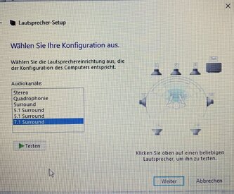

Then the HDMI interface in Windows was set to stereo, changed to 7.1
but still the Marantz shows stereo and no signal is getting to the speakers out of REW. ?

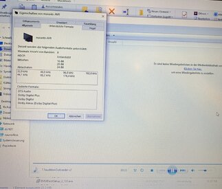

running the wav via WMP, just Stereo is getting to marantz
windows is set to 7.1 in my opinions, maybe there are more settings?

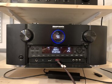

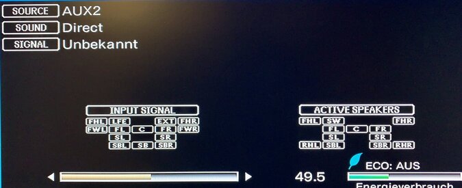

OK, so there's some problem in general, not specific to REW. While playing that WAV file, if you look at Settings->General->Information on the Marantz, what does it show for Audio Information?

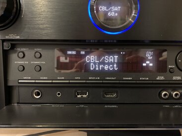

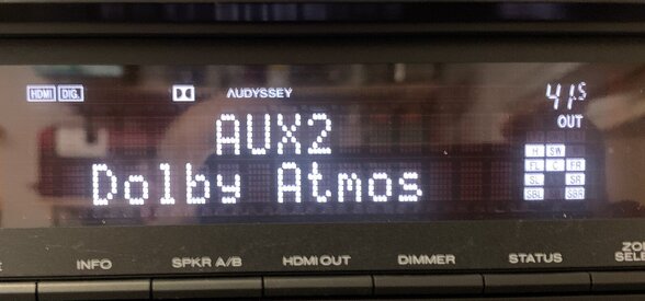

Playing an atmos demo via built in win player, all speakers are working fine, full atmos
what do you mean by settings-general-information (cannot finde that in win10)
0815
Oct 1, 2017
10
Oh OK
If I play via WMP it is Signal: PCM, Sound - Stereo 48kHz 2/0/0
If I play via Film&TV it is Signal: Direct, Sound- Dolby Atmos

It doesn't look like there was audio playing when you took that picture? What does it look like while the WAV file is actively playing?
0815
Oct 1, 2017
10

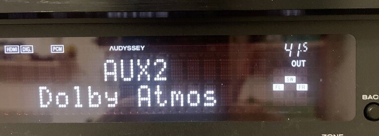

Here we go on WMP 7.1
55581
55587
this is a Atmos Sample
55583
55588
fall back is shown Stereo

OK, so it seems there's something about your Windows audio driver configuration, it appears to be forcibly downmixing to stereo.
thothsong
Jun 29, 2021
388
Look at all of the tabs for that audio output device (Enhancements, Spatial Sound, etc) to make sure you have any special processing disabled. Look to see if your laptop has some audio control panel or app that might be altering the audio processing.

IMO that Atmos test is obscuring the problem. Atmos/DTS/DD are encoded bitstreams, passed as direct/nonPCM to the AVR which decodes the bitstream to individual channels (something like multichannel mp3). But what is required here is a standard multichannel PCM playback.
I like thothsong's layer-by-layer approach - first testing the driver itself. Only after the lowest layer is confirmed to work, can the subsequent layer on top be tested (REW).

Your laptop is old enough (Win 7 originally, by the sticker) that it might not support multichannel LPCM output, and the driver is always downmixing LPCM.
