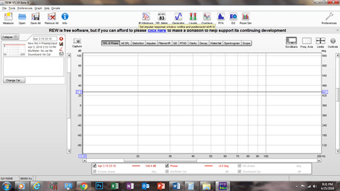

Hello to all, I'm Sean. I noticed on April 10th earlier this month that when I measured the frequencies in my room I received a measurement of -8.7 as a final result. My room measurement came back flat. However yesterday when measuring again I received a measurement of 31.2. My room is treated with acoustic foam in an isolated corner. Another thing that stopped working was my Java drivers within the preferences. I now have to use Asio drivers. I had a preamp hooked to my audio interface but removed it, and still got the same results. Could this be an issue with any of my equipment like the audio interface or my microphone? I even updated my software to the latest version. I’ll try to attach a picture of the calibration process for extra information about my problem. Thanks

Okay, my setup is a Roland octacapture audio interface, an Avalon preamp, and a Nuemann u87 microphone. Here is my results from a few weeks ago measured by REW.

Since my frequencies have changed I've unplugged my preamp, and plugged my microphone straight to my Roland Octacapture audio interface. Here are my new results!

So I read the instructions that you sent to me Mr. Poes and unfortunately I cant follow them because the app that I downloaded called Sound Meter has a db measuring feature. It also has a calibration feature, however you told me to disregard this. I don't know what to do. Perhaps I should seek another app with SPL features. Thanks
DB and SPL are referencing the same thing in this case. You should be ok.
The measurement you posted looks wrong. Not sure what happened but it looks too perfect. The best speaker in an anechoic chamber wouldn’t look that good so I’m guessing something is wrong.
Maybe adjusting the gains wasn’t a good idea. Not sure what has changed.

So Mr. Poes, I played some music and tested the SBL on my microphone inside of my vocal booth and the measurement was 33db. When I put my phone inside of the vocal booth with the music on the measurement average was 66db. I then followed the instructions and did a calibration. I put the data from my phone into the REW calibration at 66db. Then I turned the music off, and did a measurement test. Here's a picture of my result. Thanks
that doesn't look right either. The SPL level that is shown is 121 db's, which is off the charts, but even so, I can see enough in that pic to tell that you seem to not be capturing sound from your speakers. Something has gone wrong again. I would maybe play with the settings again and try unplugging and re-plugging everything. You were getting measurements that seemed plausible earlier.

So Mr. Poes I did a calibration with music playing using the " Use REW speaker cal signal option". The signal came back at 70. I then ran a measurement test and I got the same results. Only this time it went from ending in a 9 to an 8. Here's my results. I do have my preferences input set to my audio interface and my microphone. Was this the correct thing to do or should I have changed any settings within the preferences menu option? Thanks

Yeah like I mentioned before, something is off here. This is not a measurement of your speakers. It is just too flat. Not sure what is going on. When you run a sweep are you hearing something come from the speakers?
