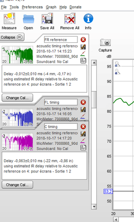

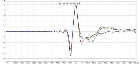

Hi,
I have installed the latest 5.19 version and I have of course the "problem" but worst (maybe because I use an external amp for front right and left speakers?) is there a way to get 0,00 delay for the reference output?. In the following file you will see different delay but all impulse seem correct!?
  • acoustic timing reference.mdat
7,314
That's fine, there is just a very small offset between the frequency range used by the timing reference signal and the overall impulse response.
