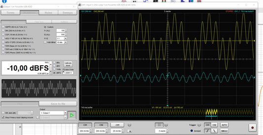

I do multitone measure and both have lots of diffrence. the mdat file i have attach too. is there any speaker that look precise ?. I use multitone 100 500 hz and 1:1 - 10 db, so no clipping. move the microphone 15 cm or 1 cm near speaker or on diffrent cone positions does not change the symetrical and look of the recordet. so no room reverb influence. i think if the level of 100 to 500 hz is diffrent signal should still be symetrical. I use loopback to see the loopback signal in channel 2, the headphone signal look even more diffrent than original or speaker signal. i understand that it can be phase shift, but so much diffrence between 100 and 500 hz ?.
Maybe in rew can add a slider to change the phase of 1 frequency ?. and when move the slider until get the original image there can see how much phase shift is between freq 1 and freq 2

EDIT: a new screenshot with better comparable levels of the headphone

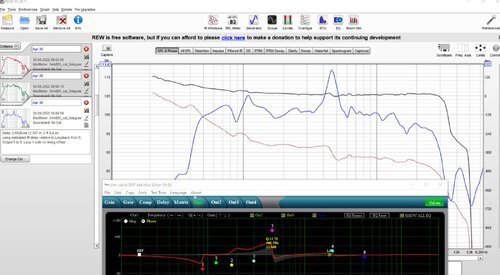

I notice that the excess phase did not show phase shifts from EQ because min phase contain too the phase shifts of the EQ. I mean this strong phase jump at 500 hz is only very few see in excess phase curve. wy this is not show ?. i use no smooth and no window and measure 1 cm away from mid/woofer. see screenshot and the phase the DSP editor show.

user44455555
Jan 16, 2021
137
ok, then it seem phase that need correct can not see on excess phase. without EQ the phase look more worse as excess phase. but it explain more wy the osciloscope display look so much diffrent
without EQ the phase at 100 hz is 255 deg and 500 hz it is 388 deg. its diffrence of 133 degree. thats much.
now how can i calc the delay that is need for the 500 hz ?. I think 100 hz have period time of 10 ms . 1 degree is 10/360 =0.027 ms *133 = 3.5 ms. so i need delay the 500 hz 3.5 ms that it fit the 100 hz right ?
In excess phase without EQ look much better .at 100 hz it is 19 deg and at 500 hz it is 3 degree. (19-3) *0.027 is only 0.432 ms .
7,297
That trend in the phase response is a consequence of the low end roll off, quite normal. It could be altered with a phase correcting filter constructed in rePhase, for example, though I don't know why one would bother.
