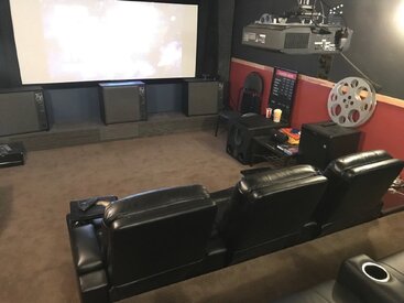

Your room situation is similar to mine (although my room is wider and a tad longer). I have a 105" cinemascope screen... which is obviously more rectangular and elongated than the HD 16:9 screen size. So, my center channel is positioned fairly high (practically the same height as the tweeters on my mains).
Of course, with a 16:9 screen, your center is going to sit lower. If you go this route, you'll need to get it as high from the floor as possible and angle toward your head.
As for screen height. That's fairly subjective and variable. I'd place it where you like. I actually don't mid a bit of an upward angle.

I agree with Todd ^^^
My 2:35:1 screen sits about 3.5ft off the floor as I wanted to fit my mains under it that way I could get a larger 120" screen in the space. My ceiling is at 8' so I have the height to get away with it. higher.
