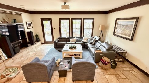

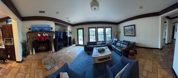

Hi All.
First time in a long time here. Please pardon the long post.
I recently decided to treat my family room, within reasonable esthetic limits. I would love some suggestions from you all, as this is my first time treating.
I attached .mdat file that included 3 sets of measurements, (1) without any treatment, (2) with bass trap (BT) in right rear corner, and (3) with the BT and Dirac Active Room Treatment enabled, ART did a reasonably good job of smoothing the nulls from room modes in SPL plot, but (obviously) couldn't do much for decay times.
I attach two pics showing the room, taken from the kitchen, which has a 12'x12' opening where the left wall would have been. There is a hallway entrance diagonally in the left rear corner. The room is fairly large, 22x18x10'. The listening position middle of back coach. BTW all dimensions accurate in the Room Sim. I treated the opening to kitchen as room as high absorbance. The room sim off by quite bit tho, I could not figure that out. Wall is drywall with very flat, hard, painted surfaces.
Not shown in the pics is with 2'x8' round bass trap tower that I had in the right rear corner, but as can be seen in the included measurements, the BT did not do a whole lot, except for in the RT decay you can see a little quicker decay in the low frequencies.
Note I can't do anything about speaker placement due to room design (the step in front of TV and the door position). Going from one sub to two had less of an impact than I hoped, probably because they are too close to each other, so basically act as one?
I'm sure if can't convince her of curtains, there are already electric blinds within each window. Unfortunately I didn't measure with them down...
I'm thinking I can get away to treat the rear wall and ceiling, and that should be a good start, possibly even enough. The goal is to make vocals (mostly jazzy music but also TV) clearer. There's bass to spare, and the Dirac ART can stay close to my preferred Harman house curve. So frequency response decent, room decay, not so much.

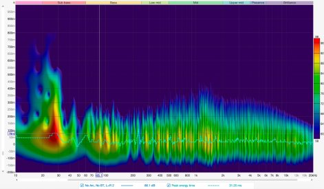

Spectrogram clearly shows bass lingers, and I need traps. Big ones.

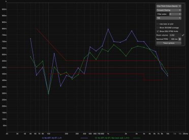

But I also suspect an RT60 decay of up to 700ms between 1-2kHz is problematic. Any thoughts welcome.
I'm thinking lots of absorption. And about as much dispersion. I already have quite a few of the 2'x4' absorbers and 2x4' slatted wood diffuser panels courtesy of GIK's Black Friday sale. But I'm still undecided where to put them and how much of it.
I think absorbers for 1st reflection and just in front and above listening position on ceiling, so basically 4 panels symmetrically around the ceiling light. And then mostly dispersion on rear wall, since I'm 6' away from back, and the wooden slats esthetically pleasing. Any thoughts?
I'm still waiting on the matching wood bass trap for right rear corner. The measurements makes me think they won't be adequate, so I might do one in right front corner too, or try to air gap.
Appreciate any input from the community, and Happy new year!

Welcome @nicol_verheem, I would think about treating corners, where three surfaces come together floor and/or ceiling... Next is two sides including wall and ceiling wall and floor... I might look at Digital Room Correction to push that hot spot down... Maybe there is a way to adjust ART down there... I'm not an ART user so I don't know what to say there... You might also look into hiding some Mass Loaded Vinyl behind some art or any absorbers you already have...
BTY, beautiful room...
Happy new year.

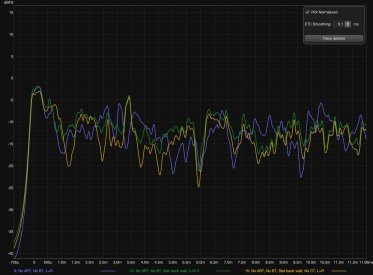

This is your RT60 with upper and lower tolerance curves calculated for your room volume (112m^3) and target of 500ms. This tells you what frequencies are within target and what you need to do. You are fortunate in that you probably don't need more bass trapping. It's the freqs above 470Hz that you need to work on, and this is relatively easy. This is "ARC L+R".

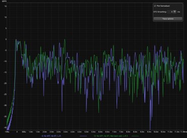

The Energy-Time Curve (ETC) shows the decay of sound after the main impulse. I chose "ARC L+R" (I presume you mean ART). Ideally, you want all specular reflections (thinner arrows) to be more than -15dB to your main impulse within the first 20ms (I drew the target in blue). Your "No ARC, No BT, L+R" looks even worse. You can work out where the reflections are coming from by calculating the distance with the speed of sound, d = c * t/1000 (c = speed of sound 1125 ft/s, t = time in milliseconds). Pick any reflection, and it had to travel an extra distance d to reach the microphone.
From your photo, the obvious culprits are your coffee table and the rear wall (behind the listening position). If you really wanted to reduce the reflections, you need to get rid of the coffee table and put something at the rear wall. But you have a gorgeous room there, it would be a real pity to ruin the aesthetics by installing foam.

It's your room, you can do what you want. But if it was me, and if I wanted to preserve my room's aesthetics, I would pull the sofa closer to the speakers. That will have the effect of delaying rear wall reflections. On the rear wall, I would put some bookshelves. You could modify some IKEA bookshelves with some absorbent foam and put indoor pot plants on the shelves to hide the foam.
It looks as if the problem frequencies are 500Hz and up. Foam needs to be 1/8 as thick as the longest wavelength you want to absorb (as a rule of thumb). A 500Hz wavelength is 686mm, so the foam needs to be 86mm (3.4") thick. That is quite achievable in most rooms.
If you want to see the effect of the coffee table, take measurements with and without it and compare the ETC. Use REW's "overlays" for a direct comparison.
+1 for the potted plants... Stands of bamboo in big pots filled with earth... Pot of earth for the lows and the bamboo for diffusion...

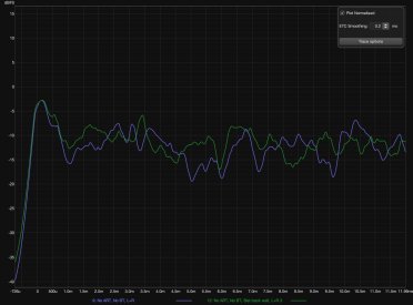

A few quick updates after first stage of treatment. Pics included. Unfortunately I didn't measure between each change, so the impact is a bit conflated.
I moved MLP couch 1' fwd, which is all I can do. It's clearly delayed some reflections (like back wall) in the ETC.
I added GIK Slatfuser 8'x8' panel behind listening position. It's quite a job to align them, but esthetically I thought it made a fairly boring wall less so. The slats achieved a decent improvement in the decay, as evident in the RT60 curve, thanks @Keith_W for the advice on what to look for.
It did not do much in the ETC (yet). Two impulses difficult to see in overlay so I added some smoothing. I'll add some absorption to see what that does.
I cleaned up the .mdat project file a bit and also tried a quick measurement with two thick blankets on the coffee table (look for "No CT" in the name). That did have a pronounced impact, but not what I expected - it didn't remove one reflection, but instead lowered a whole bunch. I interpret that as repeats, hence I'm wondering about the ceiling again.
I have some acoustic absorbing panels and bass traps on the way still, and now I will consider bamboo plants too :-)

It looks like you are making some progress... :T I wonder about the difference between the new Slatfusers with and without the picture in the middle... You might consider placing some absorption behind the couch, more of less out or sight, Soffit traps? Maybe a bigger, thicker throw rug?
We will be interested in where you put your new absorption and traps when they arrive...
I hate to tell you, but your diffusers have done diddly squat.
That's the ETC of before (orange) and after (purple). I used the left speaker with no bass traps, the only variable being the slats. I wouldn't say one is better than the other. Maybe some of the reflections in the 4-6ms range are improved.
There is a marginal improvement in the RT60.
I did say that you would be better off with absorbers.
I didn't, and still don't, disagree with your last statement - In fact fully I agree, and I still plan on adding substantial absorbers. I already have 8x of the 2x4' and 4x of 2x2' panels ready to install - recall it was only ever a question of how many of what and where to start....
The esthetics made me try the diffusers in the middle (as a start). And I was worried about deadening the room, but clearly that's not happening. But I am still planning to put diffusers next to them on both sides.
I can also still reasonably easily swap them for the absorbers in the middle, but annoyingly the GIK 2x4 diffuser and the GIK 2x4 absorber are not exactly the same size, so I might make more holes (drywall, no big deal). TBC, the slat diffusers have 2" foam behind them, so there is (supposed to be) a good bit of absorption in there too. Their graphs are very close to the absorber panels'.

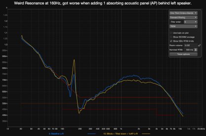

Your measurements suggest that the slatted panel is too loose on the wall, causing it to vibrate and resulting in a decay time increase and frequency boost at 100-130 hz, which is also visible in the detailed room reverberation.see here . and here are also see the settings so you can see a more precise RT60. important is: before you can see the rt60 in overlay you need go to rt60 decay tab of all you want see and press lower button generate to see rt 60 decay

I noticed something quite interesting, that I can't figure out how to interpret. On the RT60 overlay, when I look at the L+R pairs, there's a weird spike at 160Hz. Somewhat different than your spike above, this is only present on all the L+R measurements, and on none of the L or R only. So it only exists when both speakers on. What makes the plot thicken, the spike got worse when I added the absorber. I don't understand how does RT60 get worsened by adding absorption? Could it instead be the two (side firing subs) resonating (maybe slighting out of phase), and that's worse when one is dampened at higher frequencies? Any thoughts appreciated.

These are all your L+R RT60 measurements. I do not see a "weird spike at 160Hz".
In any case, the RT60 should be interpreted with caution below the transition frequency. What you are looking at is not necessarily decay, it might be a room mode. And if you haven't taken the measurement properly, you could be looking at the noise floor.
If you see something strange, you can examine it in more detail with RT60 Decay. Select the measurement you wish to examine, click on the RT60 decay tab, and click "Generate". Place your pointer on the waterfall and examine the decay in the upper window.
Re: your painting. The canvas itself is unlikely to contribute much towards reverberation, but the whole frame might vibrate against the wall. I have paintings on my drywall, and it is the wall that vibrates and bangs against my paintings. I cured that by placing felt pads on the frame. I still haven't eliminated the rattling problem somewhere in my house, it's really difficult to diagnose.
Hi Keith
Per @user44455555' process, I generated the detailed plot on RT60 decay window, before switching back to the overlays. This way the RT60 overlay has much higher resolution, even in overlay mode, i.e. at least in the T60M trace. In the jpeg snapshot I attached to above post it you can see the spike @160, whatever that is. Probably a mode? I'll try to do a screen grab tonight, since the export didn't capture the cursor or settings I used.
Re: you paintings: If the wall is vibrating, the pressure wave (sound) of that oscillation will go back into the listening room, right? I assume at whatever the natural / harmonic frequency the wall is. Might not be audible, but it should be there.
My question: Is the vibration of the frames rattling against the wall at that same frequency, or is it at a new, unique one? If the same, it just vibrate in perfect phase with the wall, and create a uniform pressure wave. The felt pads would have no effect, no? However If they vibrate at a new, different harmonic frequency (it is a new structure, after all) the felt pads merely dampens the sound of the two colliding structures (interfering waves), but the wall / frames / canvas is still creating a pressure wave, right? I wish I paid more attention in college! :dontknow:
I wonder if it makes sense to for me to try and generate a fixed 160Hz sine wave, and to see if I can hear/ feel anything suspicious or misbehaving in the room. The same might help you find the rattle. But it might also be a fools errand.
