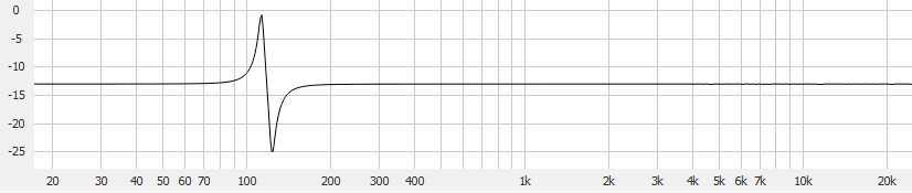

Hi everyone!
After messing around with a tone generator and an EQ I sorta managed to correct a major error in my listening setup. But only sorta...
I noticed two especially problematic frequencies:
  • 113Hz (way too quiet) ±18dB
  • 123Hz (way too loud) ±18dB
In both cases, the correction seems to work best with a very sharp Q (factor 10).
I think the 123Hz bump is simply a standing wave, when I pull it down by 18dB's the volume levels out nicely compared to lower and higher frequencies.
The 113Hz dip is a but more interesting, because this dip only occurs: in front, between the speakers. Not: in front, outside the speakers. It's as if this exact frequency is exactly 180° out of phase between both speakers.
So this made me wonder, what could be the cause of the 113Hz problem? I don't know if this makes sense, but it is as if the 123Hz bump problem is caused by the length of my room, and the 113Hz dip problem is caused by the width of my room. I am on the right track here?
I'm interested to hear what you think! :)
P.S. Attached is a screenshot of the correction curve which smooths out both, for my listening position.

Try this https://amcoustics.com/tools/amroc
Post up your .mdat file... Screen shots aren't much use... Also, a little info about your kit and room dimensions would be helpful for those of us who might help...
Depending on how narrow the dip (null) is it may be inaudible... Also, you may not want to boost it by +18db with traditional EQ...
For extra credit... What is the size/distance of a 113Hz wave? And does it equal the width of your room?
Will definitely not use +18dB EQ!
And you are spot on, the length of a single 113Hz cycle is ~3,04m.. Which is exactly the width of my room. Thanks!

Nulls caused by room mode(s) can not be corrected by boosting EQ... Because direct sound is cancelled by the reflected sound... If you try to equalize, boost, you will increase both direct and reflected sound... A catch 22... And traditional EQ at those low frequencies may cause (pre)ringing...
Speaker placement, sub placement, multi subs, and bass trapping are pretty well known solutions... And then there are some interesting ways like...
