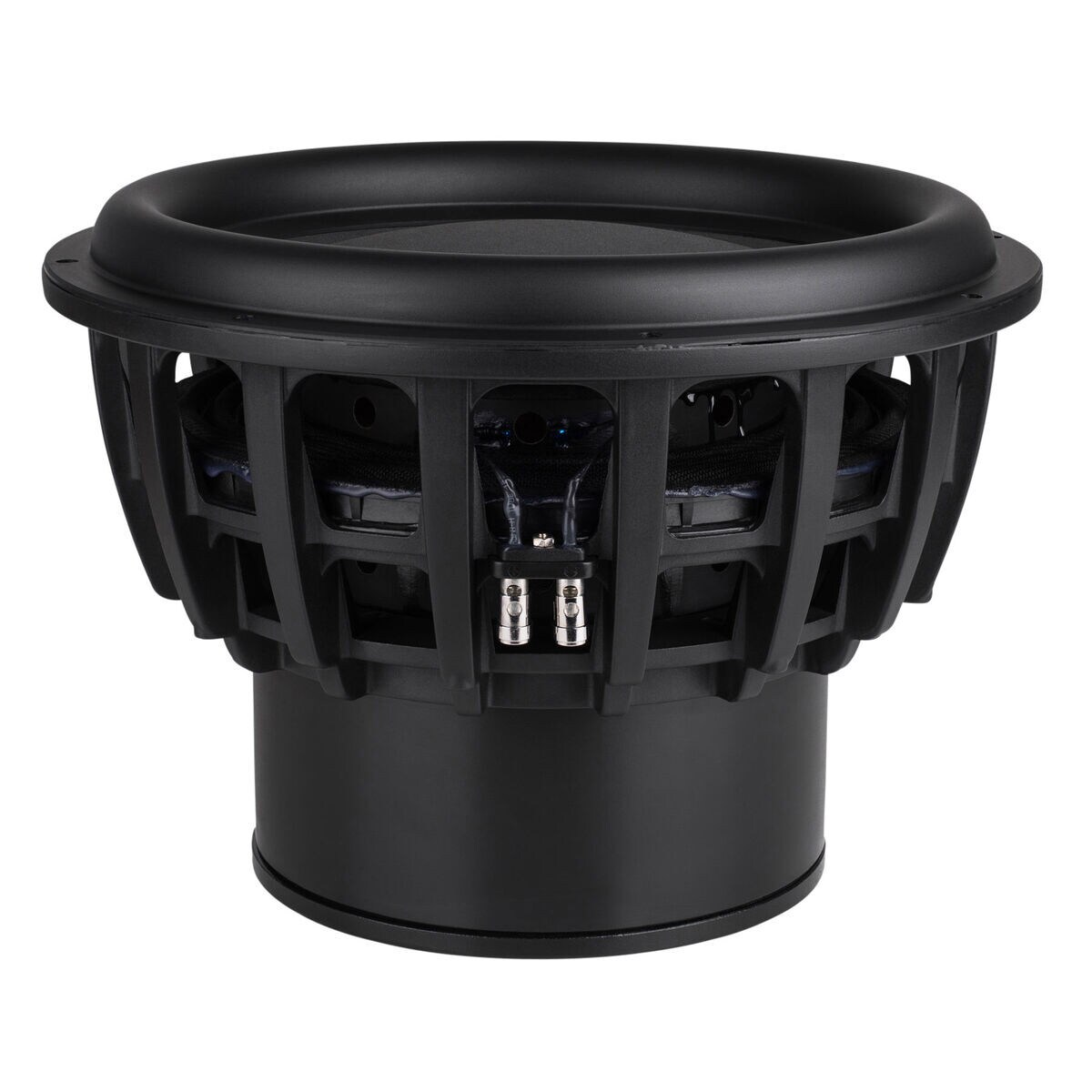

What's the story on this bad boy? 90 mm xmech? Whoa. Anybody try one?
Matthew J Poes
Oct 18, 2017
1,903
It’s the basis for the driver in the SVS 16 series. That should give you a sense of it’s performance. It’s an unusual subwoofer that has much higher linear excursion than its mechanical excursion limit would suggest.
What is cool about it is that it handles a ton of power, has loads of linear excursion, and works in really small enclosures, while still being acceptably efficient. It’s also priced a lot more modestly than other over the top 15” uber subs.

I want two of those in a sealed enclosure with a couple of Crown DSP amps, or Berry amps with miniDSP, anything that gives a nice L/T.

While it has a beefy VC and lots of room to play after Xmax its not 45mm capable one way. This driver has been talked about on other forums and the surround wont allow for 45mm one way to start. And in the market for DIY subwoofers its a nice concept but I not the best value for its actual usable excursion and price. But thats just my $.02

That's good to know. Almost certainly a performer, but not that best value.
