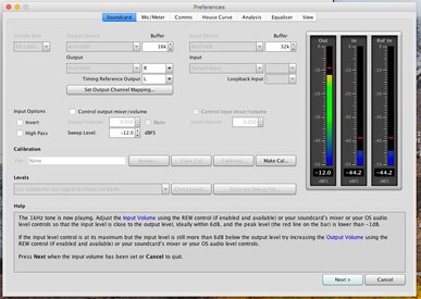

Here's a screenshot with REW set to use the AVID HD IO for both the input and output paths. The output path is working fine and is spitting 1kHz down channel 2 (this seems to be the default for some reason?) but the input is actually my display microphone (even though the input device is set to AVID HD IO).

I have been at this a while. Chasing Loopback is not helpful. In Studio terms we want to establish Record and Play, without Direct Monitoring! Back in the day, REW would not play nice with Mac at all, thus FuzzMeasure. Also Digidesign/Avid interfaces have historically been reluctant to take over the job of SoundCard in Macs. I suspect the UAD uses third party drivers, so I would park that for the moment.
Always and ever, if there is a MacBook or iMac with built in Mic, I have found it useful to first 'go native'. Get REW running using the onboard mic and speakers. Then introduce one new aspect at a time. e.g a different input chain, say Decent Mic, External Pre, Built In Line Input.
When you try to get an external interface to join the party, AudioMidi Setup is the leg opener. It has commands to instruct the OS to 'use this device for sound input' Ditto output. Make sure the Interface, OS, and REW are all on the same sample rate.
