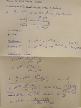

I attach a brief with an explanation of the theory, it's in Spanish but I guess maths are maths.
H12 is the transfer function between 1 and 2, using this method you avoid uncertainties caused by the differences between the mics but repeteability should be checked. Please comment your results.
