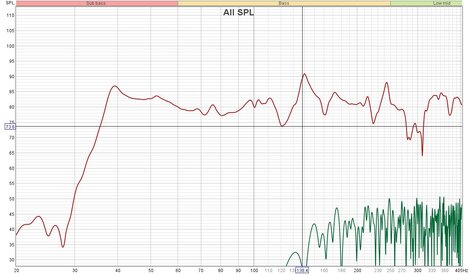

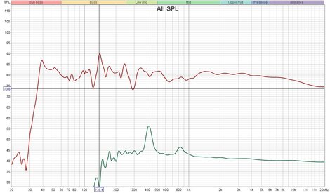

Hi there,
After treating my room, I was able to dramatically improve the response and REW is such a great help. Peaks and nulls are now +/- 6 db in the sub 250 Hz region... instead of +/- 25 db before treatment! Also the waterfall graph looks so much better now.
To bring things further together still, I inserted some cut only EQing in the monitoring section of my DAW and, although of course this does not affect the modal ringing/decay time, it again greatly helped to bring the peaks down and improve clarity in the lower register. At least that's what my ears tell me.
In order to measure what I'm hearing, I exported a sweep file from REW's generator and played + recorded it back in my DAW with the monitoring EQ engaged. The recorded waveform looks and sounds "fine" in my DAW, just like what you would expect. But after importing it in REW it looks totally wrong. I recorded it at -18 dBFS but this barely showed any signal in REW. I normalized the recorded file to -1 dBFS and it looks like in the attachment.
Clearly I am doing something wrong, but I'm unable to figure out what. Maybe some of you guys might help me? I also attached the exported sweep and the recorded impulse, if that's of any help.
Thanks in advance & cheers!
EDIT: The red line shows the room response measured "online" in REW, the green line the offline response recorded.

That's a recording of a sweep, not an impulse, to create an impulse response from it use REW's File - Import - Import sweep recordings option:
which gives:
Alternatively, and probably easier, use REW's File playback measurement. Looking at the response I suspect you might have gone a bit far with the EQ, mind.
@John Mulcahy Many thanks for your reply. Sorry for using the wrong terms, mea culpa. What you show above is excactly what I did. I imported the recording of a sweep:
But what I get looks like this:
V5.20.14 worked!
I was using V5.20.13 before but had to go back to V5.20.9 due to an error with the timing reference of the sweep file.
Your help is much appreciated, thank you @John Mulcahy !
