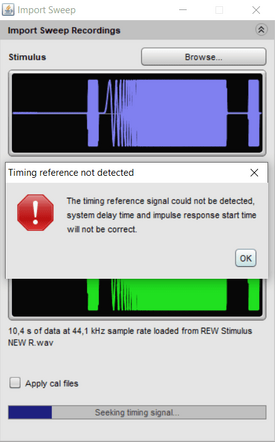

Hi John,
Importing sine sweeps recordings with timing reference doesn't seem to work in the beta build, it works fine here in the release build though.
A simple way to demonstrate this is to re-import an unaltered REW generated measurement sweep (from the same build). This does work fine in the release build.
1. Export measurement sweep:
38741
2. Try to import using 'import sweep recordings':
38743
Would love to know if this is an error on my side or wether this is a bug that could be changed.
Thanks,
Bowkey

The timing signal search on the captured sweep could terminate prematurely if it found a block of zero samples. I wouldn't expect that to happen for an actual recording, though it could for a synthesised file. I have put in a fix for the next build, can you check whether there is a problem with an actual captured file and if so please attach the stimulus and captured files used.
