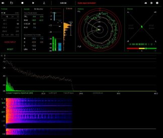

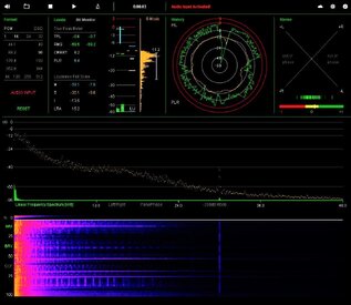

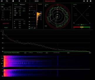

Qobuz Flac of John Williams Jurassic Park 24/96
Same song, Tidal Master 24/96
Tidal HiFi 16/44.1
The approach I used to do this is a quicker way and restricts it to 16 bit, but that has no impact on anything meaningful. The musical content here does not exceed the dynamic range of dithered 16 bit audio. That and I was only interested in showing you the HF content differences. The spectral content isn't obviously different between the MQA and Flac files, but clearly shows a difference from the 44.1khz file, which has no spectral content above that point. I think it's also fair to say there is very little musical content past 6-10khz, there is something there, but it really looks mostly like the harmonics. Most of the musical energy is actually down low. Whatever is up there, the MQA and Qobuz HD files have a bit less energy between 15 and 21khz, and when you extract the difference from the files in that range, you see it's excess noise (i.e. it's not musical). The only thing I've found evidence of in the MQA tracks vs FLAC (and I'm not confident that I have anything) is de-emphasis between 2-3khz. I need to analyze a lot more tracks before I feel confident it isn't a fluke.
In any case, I shared this just to make the point that my analysis shows you shouldn't necessarily worry to much about MQA. As far as HD content goes, with real content, I'm not seeing anything material to be concerned about so far. There isn't a lot of music up there, but it's at least not different from Qobuz Flac.

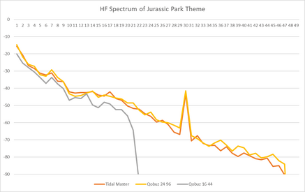

In the analysis of the file, we took the files and created differencefiles in Matlab. We could then examine those difference files against the musical content itself in the full files. For example, do they match up to the harmonics of instruments. What we found was it's just noise. It isn't musical content. This isn't about instruments having ultrasonics, this is about these particular tracks that I analyzed.
I was also talking specifically about the HF energy I found that was different between the 44.1khz file I analyzed and the 96khz file version. In this particular track, the difference was actually just noise.
I've actually analyzed quite a few files now and a lot of them show evidence of analogue bandwidth limiting. I would need the help of more experts with knowledge of the bandwithof the tape equipment, digital recorders, microphones, preamps, etc. to figure out what I am seeing, but I've found a bunch of music that looks as if it was recorded with equipment that itself rolls off above 12khz or so. I've also found a bunch that show a notch around 22khz that is fairly wide and shows evidence of aliasing above that (a mirror image). I have a feeling it has been upsampled. As such, the recording itself doesn't have any actual musical content above 22khz.
Here is another comparison graphic, but....I haven't had a chance to level match the files yet. Until I can do that, you need to ignore the absolute level differences and only look at the relative level differences. For whatever reason, the 44.1khz file from Qobuz is at a lower level above 1khz than that of the other files.
What I think is most interesting is that the HD files are far smoother in the HF spectral response than the CD quality file is. On top of that, it drops like a brick at around 19khz, even though its a 44.1khz file. The HD files show continued content that smoothly extends out to that spike and then keeps going. That spike? No idea what it is, but lots of guesses. It shows up in some tracks but not others. It isn't my system as I've confirmed it from different playback sources and differnt recording computers and methods of recording the tracks. In this case, my best guess is that its a switching frequency associated with some of the recording equipment.
@ddude003 please don't misinterpret what I'm saying about HD music here. I am defending it's existance. I'm making no statements or passing no judgement on if the ultrasonics are audible or reproducable in theory. What I'm saying is that in analyzing the files, I found that the CD quality tracks had what I and a Digital Signals expert think is a sign of less accurate sound between 10 and 20khz or so. That we also found evidence that the recordings themselves are not really of HD quality, lacking much in the way of ultrasonic content. What I'm showing you here is litterally the best thing I've found on Qobuz and Tidal so far, everything else has been MUCH worse.

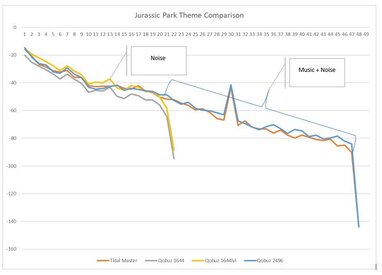

I just realized this is really confusing without seeing better what I'm talking about.
Ok so....It isn't the ultrasonics that I am saying is just noise. In the CD quality tracks, which contain no ultrasonics, there is an excess of energy between 10 and 20khz in many of the files we analyzed. When we examined it, it was just noise. The stuff above 20khz varied. Some of it was aliasing artifacts, some of it was noise, and some of it was musical harmonics.
This image with the little additions help illustrate the differences. I level matched the 16 bit file so you can see the area that is spiking above the 96khz files.
