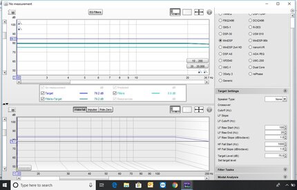

Do these settings apply to the whole speaker system? What do they actually mean?
