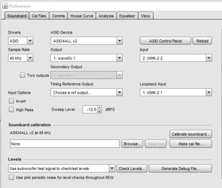

I am no expert at REW, but I have used it successfully over the years. But I am currently stumped. I have used it on current setup but not for a while. Only thing that has changed that I am aware of is the video card. It's currently a GeForce 1050 Ti; it was an NVidia Geforce 2070 super. I also changed from UMIK 1 to UMIOK 2 but swapped that back during troubleshoooting to no avail, same result.
The result is that when I run a sweep, it is garbled/staticy and cuts in/out rapidly. I can hear the sweep increasing in frequency but it is completely distorted and unusable. The only thing that really stands out to me is the output options, not what I am used to seeing; wave0c1, wave0c2 etc. Not sure what it was before but it was not that.

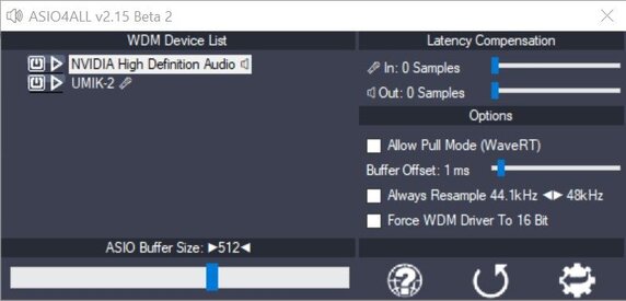

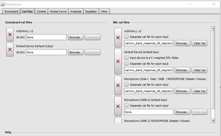

I have attached some screen shots of the preferences and ASIO control panel. Any ideas would be much welcomed! TIA.

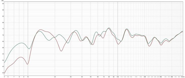

I was able to make some sweeps, the buffer didn't help. It is just horrible static over the sweep. No idea what is going on.

the reason may be incorrect operation of ASIO4ALL in Windows. Find an external sound card with two inputs and two outputs.

I second that. I've had sound glitches with AMD-based systems and ASIO4All that were fixed using FlexASIO. I fixed the glitches as follows:
In the REW Preferences, Soundcard dialog, set the devices to "FlexASIO" and set input and output devices appropriate to your setup. In the REW FlexASIO Control Panel, set "Driver Type" to "Windows Direct Sound".. To set the buffer size, I do the following.
