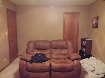

Here's the back of the room mounting options. I'm planning to change to a three-seat configuration.

http://www.hsuresearch.com/products/ccb-8.html
You must be speaking of these. They do look good. And come to think of it, it would be best to stick to high-sensitivity speakers since that is what I have up front. I'll have to do some measuring and see if it's possible to fit them. At 12" deep that may be difficult.
EDIT: Measured, they should fit as side surrounds, but they are too big for the rear wall with its doors. I'm reading your review now. Have you seen them used as on-wall surrounds? I'm not sure about that since the ports are on the back.
