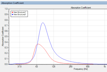

I think that soundproofing is really misunderstood, unfortunately. When I took the time to study the topic and learn what I could, I actually went back to school, literally. Of course, there is no such thing as soundproofing 501, but I met a professor who taught a course on sound transmission loss covered in a physics course. I took that and some online available architectural acoustics courses.
I won't bore you with everything I learned, but I say that to make the point that there is a lot of bad information on the web, even expressed by experts who i think attempted to reduce a complex topic into simple terms to the point of inaccuracy.
First, let's get the concept straight. Soundproof generally means stopping sound from entering or exiting a room. That can be achieved through blocking or absorbing. The techniques we use tend to do a little of both. Floyd Toole once made a point about soundproof rooms being counterproductive, that they are quite bad for bass and sound bad (as bass smoothness is a big part of our perception of overall sound quality). He's right, but one thing I think is missing from that point is conditions under which that is true, and if it is always true absolutely. A soundproof room is bad for bass when it contains all of the bass and doesn't provide any damping for it. That is sometimes true but not always true. A concrete wall, like the foundation in our basement, is a barrier, its rigid, dense, and thick. Add the dirt wall behind it and realistically little to no sound gets out. On the other hand, two layers of drywall with some damping and a decoupling mechanism doesn't really blow LF's all that much. Certainly more than a single layer did as both mass and rigidity went up, but not anything like that cement wall. On top of that a wall structure absorbs LF's. It acts like a panel trap. If you build it like a soundproof wall, you actually increase LF absorption by quite a bit. Models are not perfectly accurate but I'll include some because it at least makes the point. Actual absorption at LF's is quite a bit higher and thus reflection is quite a bit lower. They dont' accurately account for the resilience of the mounting method used nor have I been able to accurately model the effects of the damping on the drywall. While I've added a custom drywall material to approximate this, it still doesn't match real measurements (and I've been told by experts that this modeling problem is well known).
Red is a normal wall and blue is a CLD wall. Note that both are terminated walls in which one side is this drywall and the other side is going to be the cement foundation. The wall behaves differently if it has drywall on both sides.

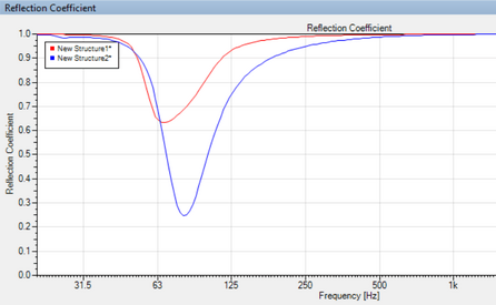

And this is the reflection.
As you can see, creating a soundproof room actually does little to contain the bass over what the concrete wall of a basement already does, but quite a bit to improve LF absorption.
