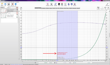

I want to return to the question of the measurement result. I measured the impedance of the inductor. Let's say I don't have a separate inductance meter. Where can I get the inductance value of the measured inductor? If follow the advice in post 7, then it is difficult to determine the point where the phase begins to fall. If move the cursor back and forth near this place, the inductance value jumps back and forth. On the second graph in my post 5 near 1 kHz shows 7.15-7.21-7.16 mH. The component model shows 6.96 mH. And if we consider that such an inductor is used as a first-order filter, then its operating frequency is 100 Hz. At 1 kHz, it almost does not affect at the frequency response graph. Near 100 Hz, its inductance is 7.19-7.20 mH. To use an inductor in a circuit, need to know its exact value. And with three decimal places. Because there is a difference, 7.121mH or 7.129mH. If you look at the latest oliver's .mdat, the last measurement, then 5.6 mH can only be seen at 20 kHz. And the component model is 12.4 mH. Is there any way to calculate the value of the inductance that is measured? Let's say as the average in a user-specified frequency range.

This can be understood as a general description of the behavior of the inductor. But if you use REW to measure inductance and use the measured value in a circuit or crossover simulator, an accurate value is required. Agree that the inductance of an inductor cannot vary from 900 Hz to 1100 Hz in this way - 7.15-7.21-7.16 mH. It's more of a computational overhead. Is it possible to calculate the average value of inductance and resistance on a selected or user-specified frequency range? For example, as in the picture.

7,212
I don't see how that would make sense. At one end of that range you have an equivalent series R of 950 mohm, at the other 2.3 ohm. If precision is important replace the inductor in your schematic with the component model, since that reflects how the component behaves, and generate your simulator responses from that. That is what the component model is for. It is contradictory to say that you need an inductance figure accurate to 3 decimal places but then to ignore the leakage and winding resistance effects.
