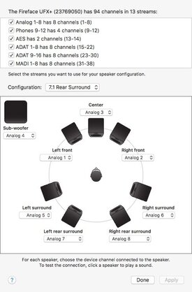

With the UFX or a similar multichannel interface REW only knows L and R as inputs and outputs.
So, in the Audio/MIDI application under Configure Speakers choose Analog 1 and Analog 2 as output (software playback). Sound from REW will be routed now to these channels, which in TotalMix can be routed to a hardware output, e.g. speakers. Route these channels to Analog 1 and Analog 2 hardware outputs and use loopback to send them back to REW, which expects input from analog 1 (L) and analog 2 (R), to make the interface calibration. Once the interface calibration is done and stored, the channel routing can be changed, eg to speakers.

Note: Signals from and to REW go through left and right, which is Analog 1 and Analog 2 (output or input).
Open Audio Midi Setup (Utilities, Application), click Configure Speaker.
Calibration: Chose Analog 1 and 2 for left and right output signals. Signals from REW will go to Playback Channel Analog 1 and 2 in Total mix. From there, route them to Analog 1 and 2 hardware output and use loopback to send signal back to REW, which expects signal from Analog 1 and 2. Check loopback function in TM manual.
