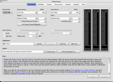

Hi everybody,
I just installed REW and would like measure my room but I can't get any input to the software.
My DAW does get the input from the microphone but having trouble with the REW.
Did watch a couple of tutorial but still need help. Would be cool if someone could help me out.
I'm using OSX 10.15.7 and the REW is V5.19.
7,212
Since 10.14 the microphone privacy settings are likely to prevent 5.19 from being able to get signals from the mic input. Use the latest beta version and allow REW to access the "microphone" when the prompt appears (MacOS uses "microphone" to refer to any input connection on any audio interface).
