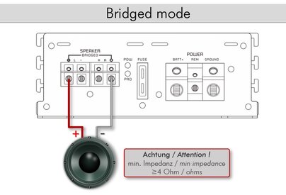

Dear lovely people,
I have a situation here I wish to seek for expertise opinion.
I have this Ground Zero Mini-Two amplifier, I read from its Owner's Manual, it has a Bridged Mode of 4 Ohm output. Is it doable if I connect the 4 Ohm Bridged mode to a 2 Ohm subwoofer?
thank you
It would not be recommended. It likely won't power the sub and could clip the amp.
Getting a dual 2-ohm sub and wiring it in parallel would be safer.
