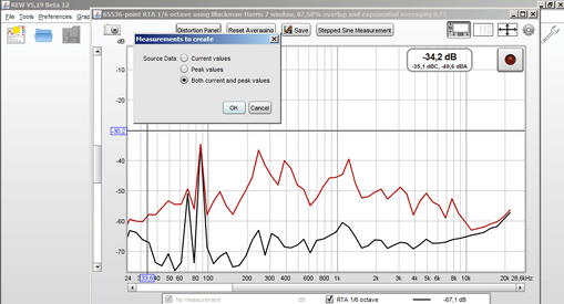

Is it possible to store the measurement in RTA mode in an overlay?
Thank you in advance)
7,315
Look at the main REW window. Every time you press save, a new measurement is created there and it becomes the currently selected measurement. The currently selected measurement is shown in the RTA window, you can select any of the other measurements and then whichever one you select will be shown in the RTA window. Besides clicking on a measurement in the main REW window you can also select one of the first 9 measurements by pressing Alt+1..9, or select the previous measurement by pressing Alt+up arrow or the next measurement by pressing Alt+down arrow. All the shortcuts are listed in the help.
7,315
Use the 5.19 beta versions from the downloads section, you are offered the choice of saving the current values, peak values or both.

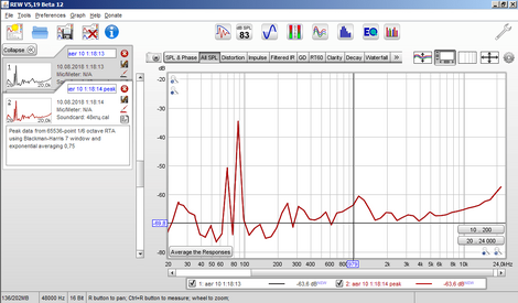

5.19 beta 12
7,315
OK, now I see what you mean :). Peak values were only being properly saved in the spectrum view, I've fixed that for the next release.
