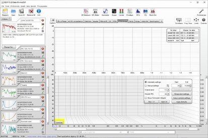

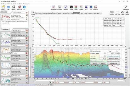

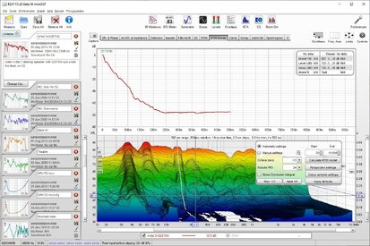

The plots on the RT60 graph are generated automatically when the graph is selected or when any setting in the graph controls is changed, there isn't a Generate button. On the RT60 Decay graph the Generate button is in the lower waterfall plot window, after using that the "Calculate RT60 model" button in the graph controls is enabled which runs the model fit.

The button to show the graph controls is in the top right corner above the graph. Calculate RT60 model is enabled after the waterfall plot for the chosen octave fraction has been generated using the Generate button.
