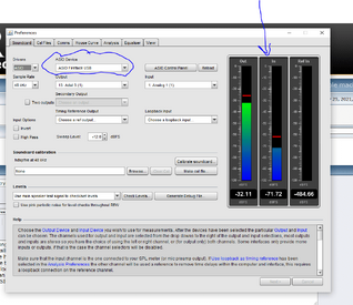

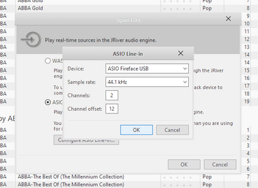

I am sending a signal from REW using ADAT 3/4 which is ASIO channels 13 and 14. I have set Offset at 12 and tried many different Offsets to see what happens.
Attached is the Pic of REW preferences. as you can see I have the Mic working and I have an output signal going to ADAT 3 using the REW speaker cal noise generator.

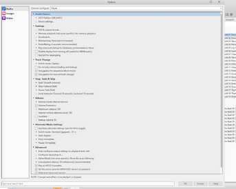

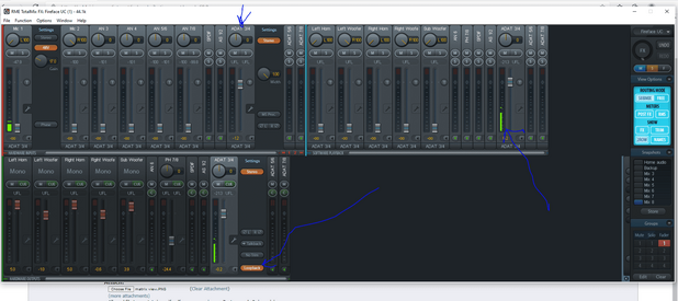

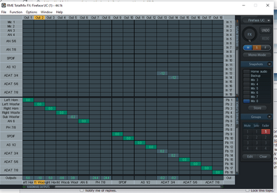

Also you can see on Totalmix it is seeing the signal from REW on ADAT 3/4 and I have set loopback to go back to ADAT 3/4 input which I am can not get JRiver to see on live in. I have also included some snipits from JRiver on what I have setup.

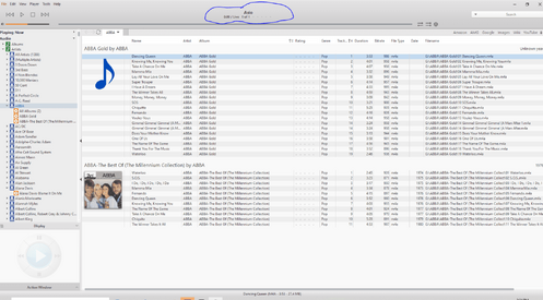

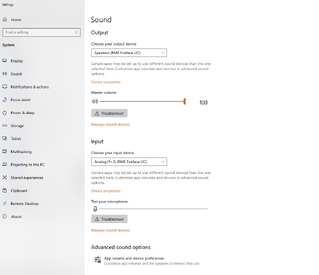

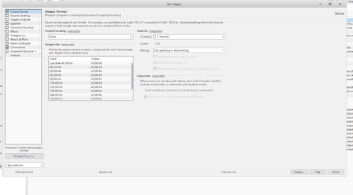

As you can see JRiver is trying to play Live in but nothing. Also JRiver has crashed so many times my View has changed and I no longer have my normal view with the JRiver Emblem up top and I can not get it back. Any ideas there?? I just have this plain jane view now and cant get the normal look back.
