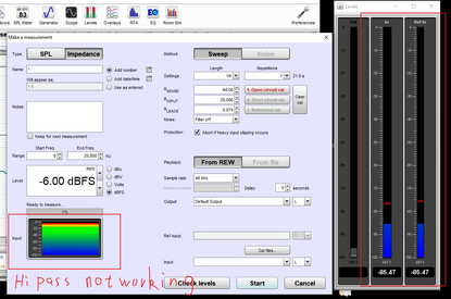

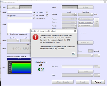

Today i trying to use a soundcard to measurement impedance,but looks like hi pass not working on measurement(but works on levels),so i can"t do imp cal. It will be great if hi pass works again;)

Did you select the High Pass input option on the REW soundcard preferences? Why haven't you selected the input or output?
I did all,input hi pass checked on the prefences,input is line in L,reference input is line in R,out put is line out L.

now,im sure about some thing:
(1)5.20.3 impedance calibration and measurement is working,
(2)5.20.4 fail on impedance short calibration,i don't know why.
(3)“hi pass” is working,but level meter display on measure page looks wrong.

I did made input and output selections on the REW soundcard preferences ,but some times,it is not show on the measure page.i did again.
and you right,5.20.3 doesn't make the validity check, that doesn't mean the result is valid.
i think someting wrong with this soundcard,not just DC .
I have worked out why the level meter display on the Measure dialog is not taking the HP into account and fixed that for the next build.
