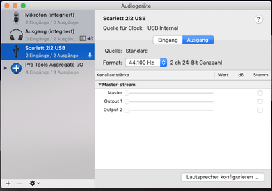

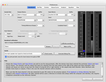

Can you post screenshots of the REW soundcard preferences and the Audio Midi Setup utility settings for the 2i2 outputs?
acusticman031
Jul 18, 2020
ich habe auch schon versucht das Scarlett als Output Device zu verwenden, über den Monitorausgang so wie in der DAW, jedoch ohne Erfolg.

To use the Scarlett as the output you would need to use its Line Outputs. You are not trying to monitor the input, but to pass through the signal from REW. Monitoring should be turned off, none of the input signal should appear on the output.
The Mac's built-in output should work though, make sure it is set to the same sample rate and format as the Scarlett's input and that the output volume isn't set to zero.
acusticman031
Jul 18, 2020
Es hat funktioniert. Das Problem war, dass ich über die Funktion "calibrate soundcard" und nicht über "check levels" gehen musste um ein Rauschen zu bekommen.
