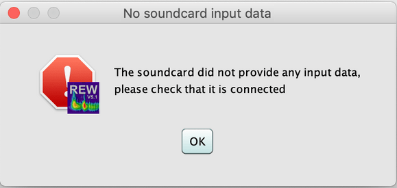

Morten Lindberg
Apr 17, 2018
Are there any known incompatibilities with macOS Mojave release version 10.14? I have problems with the REW not allowed to communicate with measurement microphone, reporting Sound Card not available. Using the UMIK-1, but the problem is consistent with any input device.
7,296
Haven't heard of any Morten, though there may not be many running it yet ahead of the release. Have Apple added a privacy setting that could be preventing access? The last Windows update had that issue, but hadn't heard of anything similar with macOS.
