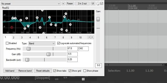

hi I want to try the following
I start a in REW so I can measurre my front channel.
the filter results put I in Reaper see screenshot.
but my wish are how can I control the measure after the correction in reaper, when I start again REW the results are without Reaper.
so I need to find a way where I can measure in Reaper

Any EQ settings REW recommends or generates, you will need to manually put them into Reaper, and then take another REW measurement.
Don’t get caught up over-equalizing your main speakers – typically 4-5 parametric filters are all that is needed. The goal is to smooth the worst peaks and troughs, not try to achieve a flat line.
