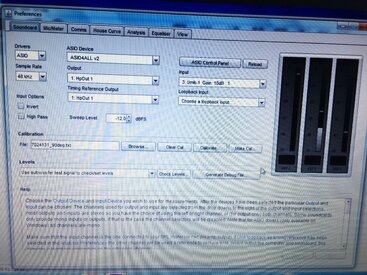

I have it all set up and made a few measurements. Generated graphs w/o any issues. However is there a way to measure the subs only? I have "use subwoofer test signal to chk/set levels" in the preference box. No matter what I only get signal through the fronts. My goal is to use the MiniDSP for the subs and perhaps with the mains too. Help?

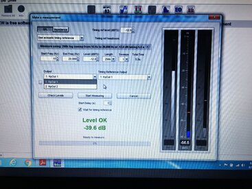

After selecting/clicking on Measure, select #3 on the Output and it should send the sweep thru the sub only.
You will want to make sure your computer is setup for 5.1 or 7.1 so that the HDMI output is in sync with ASIO.

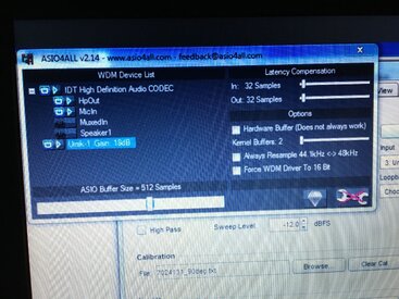

This is what I show only. Win 7

Just a stereo output from the laptop Mitch? For sub only disconnect the mains, or connect an analog output directly to the sub.
Sonnie, output #3 is usually the centre channel on HDMI (counting from 1), #4 is the sub.
5,192
Are you using HDMI from your computer to your AVR?
If so, and if you are only showing 2 outputs available, then your computer is likely not configured for the LFE .1 channel. If you go into Playback Devices and select your HDMI output, then Configure, you should be able to change it to 5.1 or 7.1. You may have to restart your computer for it to work.
If you are only using analog, then as John pointed out, you can connect directly to the sub amp.
I stand corrected... sub out is indeed #4.

All this makes sense but after looking in playback devices I don't have any hdmi capabilities because I lacked the correct driver. Wasnt in my win 10 PC either. Installed the drivers and what do you know...got it configured to 7.1. Now I just have to see it I can get the driver installed on the laptop win 7.
