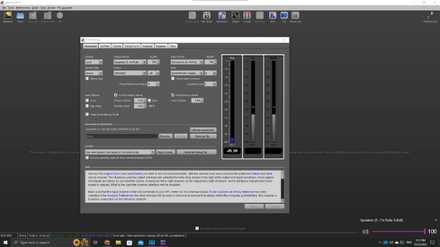

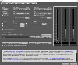

Hello, I am trying to make some measurements using REW. For some reason I cant make REW to output any audio. I have selected my DAC in the preferences and set up everything as pictured in the attached screenshot. The correct output is selected in the windows mixer and volume is set to max. The dac/amp volume is ok, and besides the audio works fine with any other program.
I have tried to connect my amp directly to my motherboard and i still get no sound out of REW. Output lvl always displays -95.99 no mater the output device or settings. What am I doing wrong ? I used rew with success in the past with this configuration.

It still shows that after you press Next to go to the second step of check levels? Nothing is sent to the output until the second step, until then it will just show -95.99.

:sad:...sorry I didn't mess around further, I completely overlooked this.
Thanks for your time.
