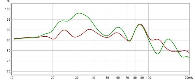

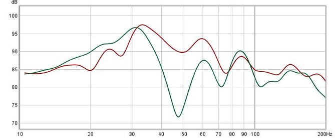

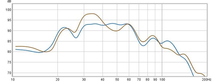

Next issue is to get these setup so took tips from You tube vids on Gain matching and Alignment, to enable this I have added a Mini-DSP 2x4HD and using REW with UMIK-1 I got what I think was the aim is that with both subwoofers I get a output gain, which is shown in the attached graph.I have also attached the subs seperate measurements.
so I re-run ARC and again poor bass so I made some adjustments but I still lack Bass chest thump..
Can anyone help further as I would expect in a room this size the 2 subwoofers to be enough?
room size is length 5.36 m * width 2.56m *height 2.57m I have 2 doors both on the left side of the room, one front left and the other rear left, so the front left is the main entrance so cannot put subwoofer front left. Room has no treatments, flooring is carpet and all walls are standard 12mm plasterboard.
all pics have 1/6th smoothing applied in REW
1st pic green line is front sub
2nd pic green line has a 6db delay set on front sub via mini dsp
3rd pic blue line has ARC EQ applied with no tweaks

Look at the combined response. You have to equalize both subs together and look a their combined response. Then correct your response based on how they measure together.
I thought i was looking at combined response? the first graph shows seperate and the others are both subs on together so both together does appear to cancel out the large null from the front sub and then adding the delay increases the combined output. The aligned subs are then treated as one by Anthem ARC process.. It does look like the filters ARC applies flatten the mid bass in the graph
I do not listen at reference levels as that is painful for me, so the tweaks applied previously have included a house curve or slope which is through the ARC customisation although not applied for the graphs uploaded

I'm confused... why do you have 6 different responses in the graphs above? You should only have one starting response, with no processing... it would typically be the same on all graphs if you want to split up the different processed results. It doesn't look like ARC is doing the job for you to be quite frank. The second graph with the red response looks to be the best, with the exception of the 85-90Hz peak. You could increase the overall bass volume at the subs to get more bass presence. We would also need to see how it integrates with your main speakers to know if everything looks okay.
You can also use the miniDSP as a parametric EQ and tame some of the issues.
