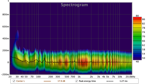

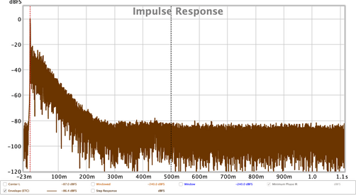

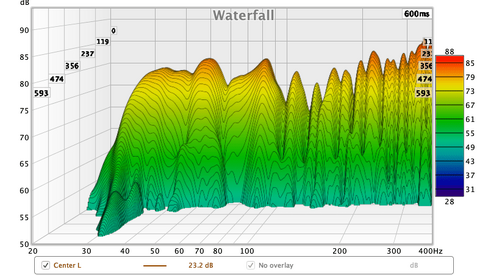

REW Measurements
Freedom_Finder
Jan 5, 2020

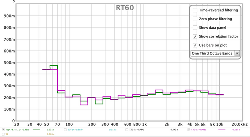

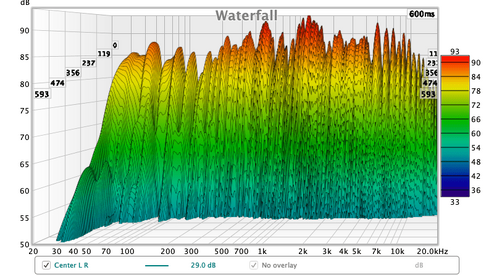

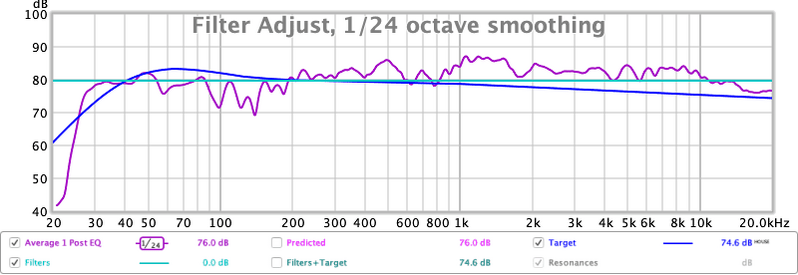

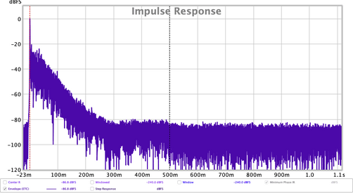

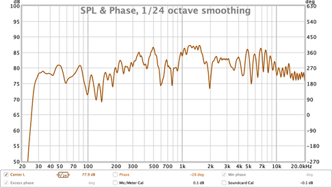

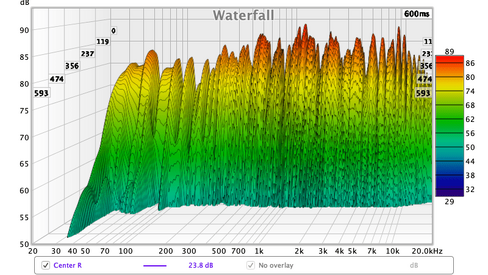

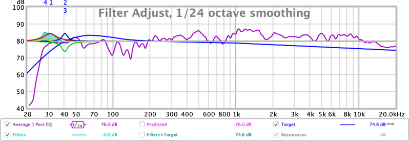

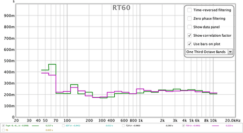

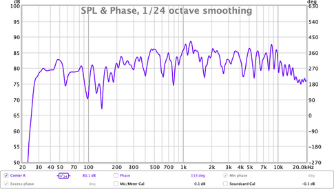

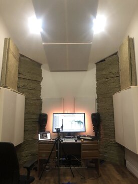

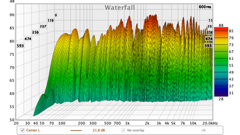

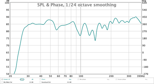

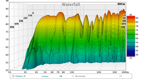

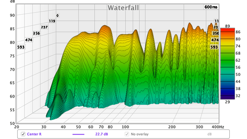

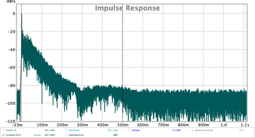

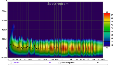

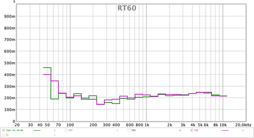

This is my first post and REW measurements
Fingers crossed I've done okay to start.
Really appreciate any input you may have,
Thank you!
Measurements are post room treatment, and Dip switches on the monitors

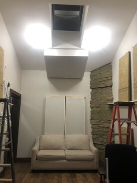

DanDan
Mar 10, 2018
743
Pretty good, 200mS -400mS is within the EBU standards. The midrange rise makes me a bit uncomfortable, but then the NS10 was very popular. How does it sound? I recommend a little experiment. Remove those Front Wall panels, move the speakers to virtually touching the FW, (Masking tape prevents scratches) Also both with and without those FW panels try width and listener position variations. Let's see if that beefs up your LF response. I would apply a house curve, perhaps using just the onboard Eq on the speakers. I favour the Bruel and Kjaer Curve and use Dirac Live to implement it.
