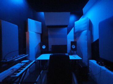

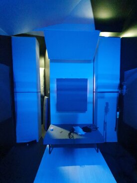

in regards to room treatment.... basically all bass traps... which also act as broadband and high (see images) and exactly what you said about mids and presence is true...
What are your thoughts? I thought I needed more treatment haha....
But I think the low end of this mix is sitting tight.. maybe a bit too punchy but tight?

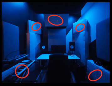

The blue is cool. Are all the traps DIY? It seems, you have overdamped your room. I would slowly start by removing the absorber under the keyboard and the ones were the headphones are lying on -> make a measurement and compare to status quo. Then the smaller ones in the corners -> measure and compare RT60. Plan of action down below.

OK, I actually just put these in a few days ago.... and yes all traps are DIY.
In regards to everything you circled... they are all new...
I have attached a mix/production I done before they were installed.
