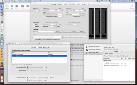

Sure, here you are. From my perspective, everything is set up properly. Like I said, the mic is working perfectly. Audionet Carma for instance is working great but lacking many of the great features of REW.

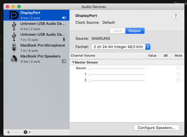

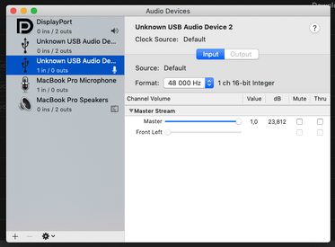

Sure thing! Here you go.

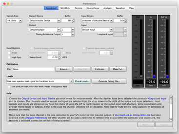

Are you using a UMIK or something else, Petter? A UMIK should appear as "Umik-1 Gain: 18 dB". Can you also show a screenshot of your REW soundcard preferences?
I'm using the Dayton Audio EMM-6 with a USB dongle/soundcard thingy to provide phantom power.
I've also tried using Dayton Audio iMM-6 which is just a regular mic using the minijack input/output on the mac.
7,314
Best select 48k in REW, same as the Audio Midi Setup setting. Shouldn't make any difference but keeping them the same avoids resampling in the OS.
Is there an option other than "Default input" for the input selection? If so, try selecting that.
As a final attempt could try leaving the input device set to Default device (since the external mic is selected as the macOS input anyway) and see if that works any better.
I'm none the wiser about what could be causing this, beyond the possibility of a bug in the macOS JavaSound layer. The REW code is the same for Windows, Linux and macOS and I haven't seen reports of anything similar on the other platforms, it is a tricky one to understand.
