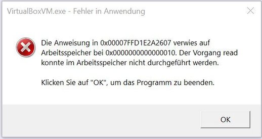

Dear John and FOrum,
so I am using a Virtual Box (v6.1.31) VM with Win11 v21H2. When I am installing REW the progress bar goes to 99% but then the VM crashes with the info enclosed. Sorry for the prompt being german, but it basically says it wants to access a storage address which is not allowed. Looks like it is the first storage address. Do you have an idea how to fix this?

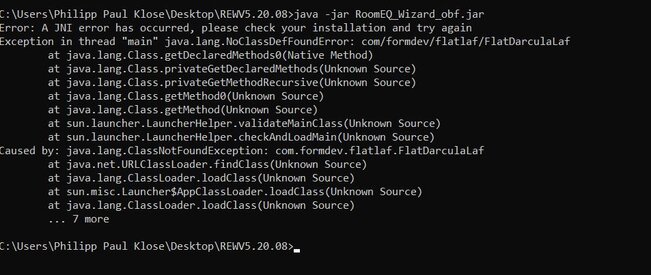

I get the feeling that Java 8 has a problem here. Install of the runtime env went fine, but when I try to configure Java or check the version, it crashes like the install of REW I explained further up.
Will get that message when following your instructions though.
