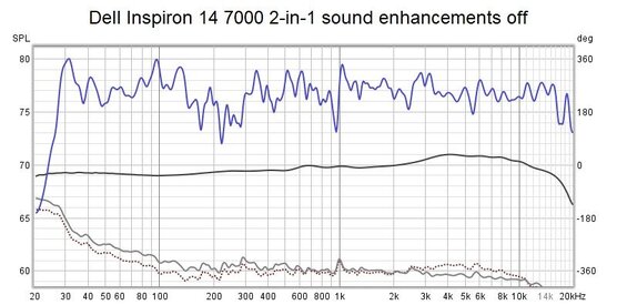

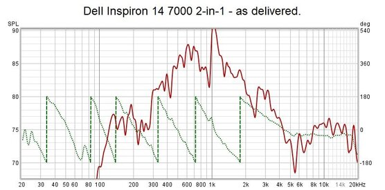

Dave and John - thank you both for this thread.
I had purchased a Dell Inspiron 14 7000 with AMD Ryzen about a year ago to replace an ageing Asus Vivo Book, but until finding this thread today I could not get a good measurement with REW on the Dell.
The measurements show how bad the Dell audio enhancements are, the measurements are of my tri amped K-horns with a miniDSP UMIK-1 and with sound enhancements off, match the Asus Vivo Book.
I wonder how many new REW users with Win11 PCs have had crap results.
The Dell has similar obscure controls to Dave's HP.
