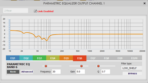

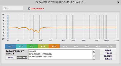

I do it a little different. I sometimes listen to music with Yamaha Volume turned ON (which adjusts the bass and treble according to the volume level) and sometimes with it OFF. I don't want a house curve when YV is ON and vice-versa. So I use REW to get a flat response, import it to each of the miniDSP 2x4 HD configs, then add a LOW_SHELF filter to the configs where I want a curve. When I listen with YV turned ON, I select the flat config, otherwise I select the LOW_SHELF config.
I use config 4 for BEQ when I watch movies.
This works very well for me, but I don't know if it meets your needs.

thank you so much for bringing me in that direction - this was exactly what I was after. Only thing now - it does not stop at 30 hz but contrinues upwards - but now it's at the same level. Config 1 is flat and then LS filter at 30 hz Q 0.7 and then 4 db, 6 db and 8 db (maybe too much - will see).
Btw when you make the eq - what do you use for meassurement - java or some of the ASIO variants - asio4all / flexasio. I correct from 18 hz to 105 and then I dare to boost 9 db on single ones and 5 db overall. Flatness = 3 db and smoothing was 1_24. Before that I used var.smoothing but then it used all 10 slots.
Here is how it looks now
I have a nasty dip at 51 hz and have it reduced.
Not sure why it rises from 100 hz and up. The initial raw meassurement was done with minidsp / usb as source and this now was done with flexasio (also done another day so mic could be a little diff. placed). Anyway you get picture.
Here's an explanation of the miniDSP shelf filters, which states that the target frequency is the mid point of the filter, so in your case <30hz would continue to rise.
That looks really good! I don't think you'd be able to hear that narrow dip.
