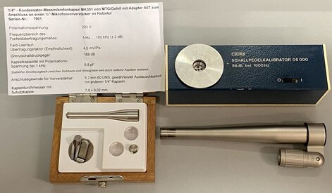

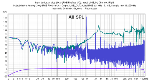

I tried this recommended SPL meter cal procedure several times with reproducible results. I did not use an REW/soundcard driven sound source but an independent SPL calibrator with a steady 1kHz sine tone instead (94dB SPL in a small sealed chamber, which fits to the mic capsule only), see photo.
The following measurements show an 1kHz-level of >130dB SPL, whereas it should be 94dB SPL.
The Piezobuzzer is only for checking the ultrasound capability of the mic.
What am I doing wrong?

REW doesn't need to know the test signal, it is just calculating the rms level of the input and the factor needed to convert that to the entered SPL figure.
When you run the calibrator after SPL calibration what level does the REW SPL meter show? Not 94 dB?
Note that it does not make sense to make a sweep measurement of a calibrator signal as the response is not related to the stimulus, to observe the calibrator signal use the RTA in spectrum mode.

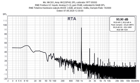

aha, the last remark points to the same direction. So only the sweep measurement is not suitable.
I will try the RTA mode next time.
Thank you very much!
Cheers, Timo

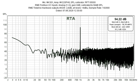

The RTA measurement seems to show the correct levels. The Measurement was conducted using different gains in the RME input of 0 dB and +55dB, respectively.
20200807_REW-RTA_calibrator_02_RME+0dB.png 20200807_REW-RTA_calibrator_01_RME+55dB.png

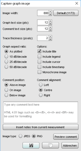

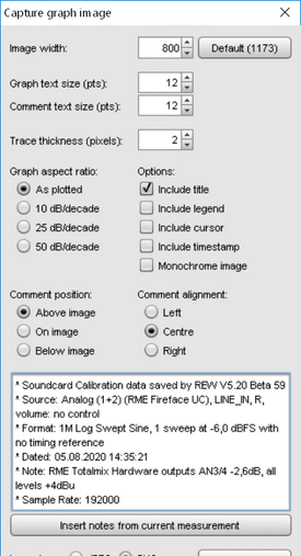

A hint regarding REW capture function:
If the comment grows "too big", the dialog elements (especially the lower buttons) run out of the box.
If possible, I'd like the dialog box to be variable in size by dragging the frame or corner.
I have changed it so that a scroll bar appears if the comments are longer than the box can accommodate.

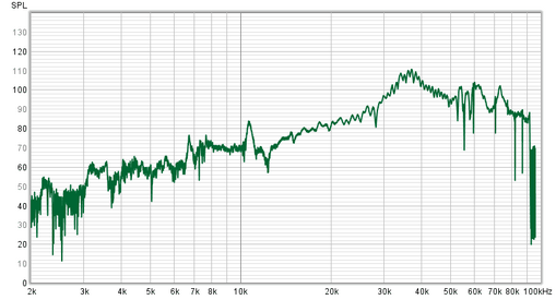

The software works fine for this application, except for some discontinuities from time to time. It can be observed by watching the "signal" LEDs at the soundcard's front. The result is a drop (or some of them) in the spectrum, to be seen in the picture below, above 80kHz. Sometimes it helps to change the input/output device buffer's sizes.
Sometimes also REW seems to output short signal bursts after the measurement has ended. But it changes from measurement to measurement, so it's not clearly reproducible.
