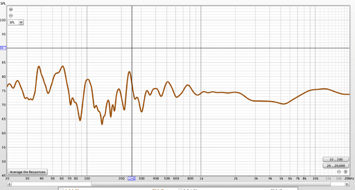

Hi Folks. Newbie here. I have performed my first measurement with UMIK-1 and REW. I need your help to understand how to generate & translate my EQ measurements into RME parameters.
I could not find a way to generate EQ according to RME parameters and capabilities. I tried using Generic EQ with 7 filters but didn't work out well. Please note that: RME has 5 EQ + 2 (Bass/Treble)
- Please see my measurement as attached

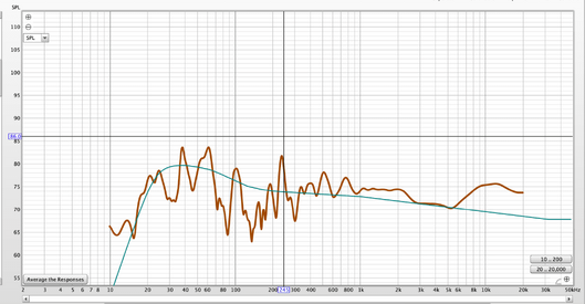

- I measured with sub-on crossover 60hz
- I use a custom Herman house curve, that I found online as follows:
  • 31.5 6
  • 40 5.9
  • 50 5.5
  • 63 4.9
  • 80 3.7
  • 100 2.5
  • 125 1.3
  • 160 0.6
  • 200 0.2
  • 250 0
  • 1000 -1
  • 32000 -6
Please let me know if there is any recommended setting for generating EQ.
If you could be more specific someone may have an idea.
I attempted to generally answer how one might use REW to generate filters given the limitations of the RME PEQ before. Perhaps unsuccessfully, but FWIW here’s the thread.
Perhaps you might find something useful there.
Hey thanks for getting back to me.
I read your post. It somehow made sense to me. Even though, I still have some confusion on how to tailor the EQ generation based on RME capabilities. As you know, RME used to have 5 EQ lines, however, since then they added Base and Treble as EQ lines, so there will be 7 EQ in total. What I’m very confused about is, how to tell REW to add base/and treble (as an EQ line) to generate a 7 line EQ. I am totally confused about how to generate/filter EQs. If you give me some tips on how to go step by step I would appreciate it.
