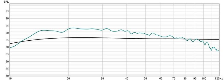

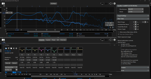

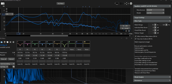

Response is below 20HZ- before updating I could easily correct as low as I needed.. Also its corrections are now lazy- it leaves 3-4 filters unused while giving a crappy response. PRE-20.14 this is how flat I could get my response.. Now it just gives up- if i remove my 120HZ cutoff and drag that to 80HZ then it will.. I love the new features but it really sucks for corrections now- I have to go back a few versions so I can actually have a proper corrections again.
Attached is what i used to be able to do - that super response, also attached is what rew does now----yes I know my tuning is different. Still leaves filters unused- telling me REW cant do better then that with 3 more filters? Also attached is NEW REW if i uncheck narrow filters--again leaves filters unused drops response below line even though entire response is above it,,......Telling you there is something seriously off with the new REW version

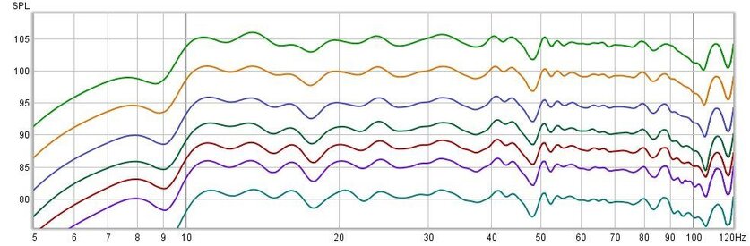

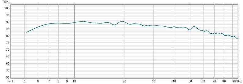

Here are a couple more rew sessions I have done- no issues correcting under 20 hz- no issues getting pretty flat response.. Trying to find my DL of that version so I can go back as I rather not use MSO-

Appreciate it- I know human error can happen but my settings haven't changed that I know of. I love rise to start at 100hz and flatten out at 30hz with average 3- 6db incline. My measurements are always above the correction path so there is no boosting only cuts. Best I can do now still give me huge sings in frq- I did try Generic- 96KHZ added 15filters made sure it was from 10hz-120hz range and it still refused to use more then 6 filters. I Have the 10 filters per channel plus 7 additional on input to use- since this will be for a blanket DSP.

Using the room curve for that isn't a good approach with the response you have. If there was tons of excess low end response that might work, but your response is broadly level below 100 Hz so trying to use the room curve in that way forces a very low target level, which in turn means the filters are being used largely as level controls. A better approach is to to dedicate one filter as a low shelf to produce the desired room curve after you have EQ'd to the target without a room curve. That means you can tweak it afterwards without having to recalculate all the EQ filters, so a bit more or less low end boost is just changing the gain and making the rise shallower/steeper is just changing the Q. Here is how a single filter could give a target very close to what you had set:
To use that approach either disable one filter before doing the target match so it isn't available to REW or set it to LS Q with zero gain. You can then use a more sensible target level, here is an example using 83 dB with your measurement with the 10 to 120 Hz match range:
and here it is with the 5 dB LS Q at 55 Hz:
You can tweak the shelf filter by moving the mouse over it's circle on the filter adjust graph and dragging it around to change gain and frequency or using the mouse wheel to change Q, hold the Alt key for fine adjustment with the mouse wheel.

Are you using an old 5.20.14 build? The EQ filters panel should only be showing the number of filters that have been configured, your screen captures show a lot of extra disabled filters. The latest build is linked in the first post of the 5.20.14 early access thread.
7,296
That measurement has a different configurable EQ setup, with 20 filters and a different Q definition. It has used the 10 enabled filters though and has a very close match to the target, is it not what you were expecting?
