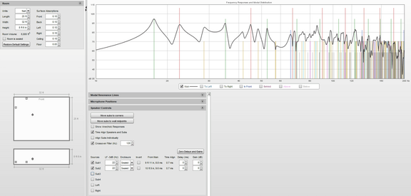

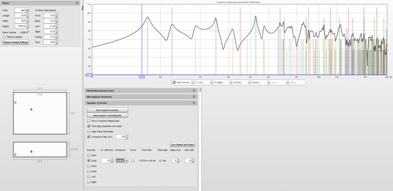

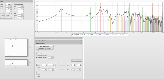

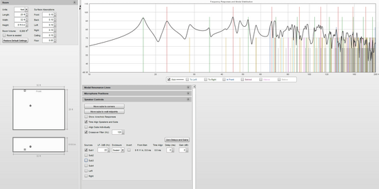

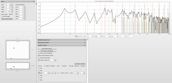

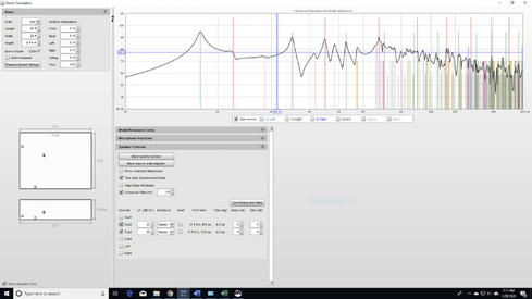

I'm hoping someone here can help me interpret these results. I'm putting together a new system and am very limited in subwoofer placement and size. I've only got 3 places the subwoofer can go so I'm trying to figure out what I should look at ordering, using these results as a guide. I can go one of 2 ways: 1 larger sealed subwoofer (narrowed down to HSU ULS-15 MK2 or SVS SB2000 pro/SB3000 as something with built in EQ) or dual smaller, lower end ones (SVS PB-1000 largest ported sub I can fit due to height, could go with 2 SVS SB12-NSD as well).
I understand that the room sim can only be so accurate so I will order from somewhere I can send back. But my hope is that these results give enough info to maybe make the right choice up front. Please see attached Room Sim results

The responses with 2 subs generally look a little easier to manage than the single sub responses.
