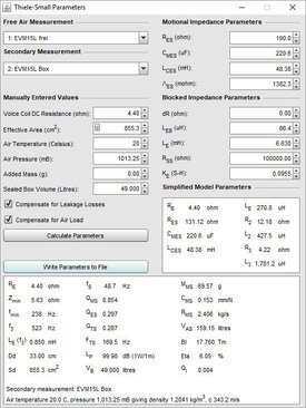

I have problems with the TS-Parameters Tool since about 1/2 year: Volume method leads to giant Vas results (that just can't be true: it's between 2000 and 4000 litres) and I don't know what's going wrong here. This happens on different machines with different Java Versions (tried OpenJDK and Oracle Java).
I attached a file with some measuring results. Here is the list to understand what I did on what measurement:
1: First time the problem appeared - free measurement
2: First time the problem appeared - measured in 49-litres-sealed-box
3: new attempt - free measurement
4: new attempt - measurement with weight (but I forgot how much g it was)
5: latest attempt with sealed box (49l)
6: latest attempt - free measurement
7: latest attempt - weight method (50g)
The weight method seems to work fine, at least it leads to a Vas around 180l which seems reasonable. But my problem is that I don't owe a fine scaled weighing machine so I can't trust the measurements. Best thing was the volume method would work again…
Any idea?
