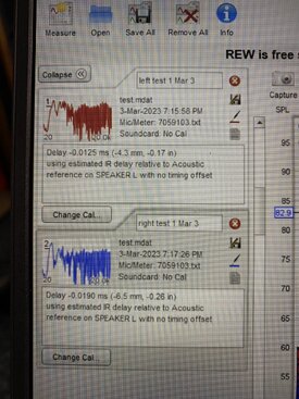

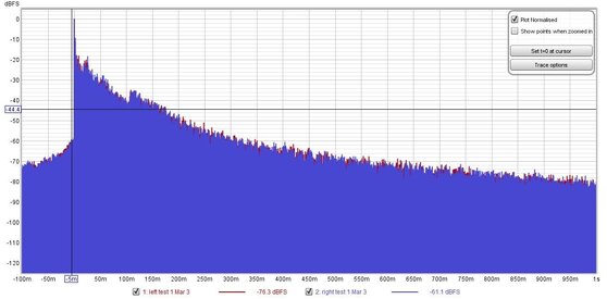

Bobski321
Apr 4, 2021
14
So…. You’re probably going to laugh, and say that these look pretty good, right? I actually did do a couple more and they did stay pretty much the same.
Last time I experimented with this, I had a fairly large wideband driver…. And now I’m using a regular two-way bookshelf. Maybe that was why I was getting larger inconsistencies?
