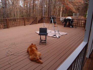

Here is one response file and a photo of my setup.

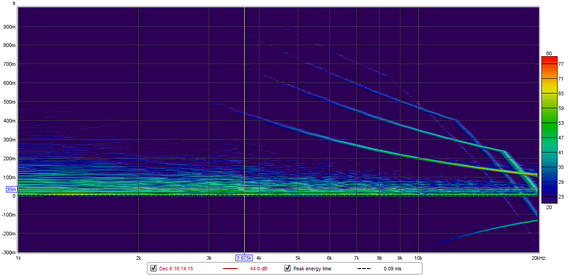

7,298
That is a very odd looking impulse response. There is a lot of high frequency energy very late in the response, and quite odd behaviour ahead of the peak. The spectrogram below, using a 10ms window to better capture the HF behaviour, shows some strange goings-on. There is no output device selection in the file, what are you using for the output chain? Is the device being used for output set to the same 48k sample rate as REW?
