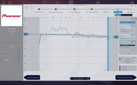

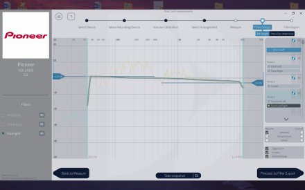

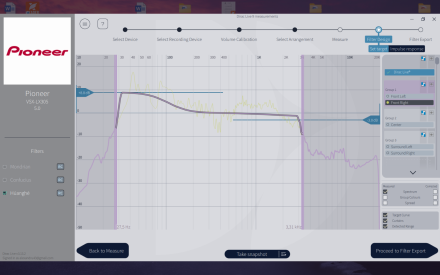

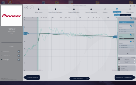

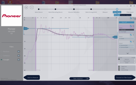

I have a problem at exporting filters at the end of calibration with Dirac Life, using a UMIK-1 microphone (on laptop with Windows 11): I successfully made 9 measurements, and after finishing exporting the 3 filters (after each one I got the message: successfully exported to Pioneer LX305), still I dont have a "successfuly finished" message, or ok, or something to end the calibration procedure. I am left at same filter export section and I have the option either to go back to filter design, or re-export the filters and replacing the existing (already exported) filters...Why is that?
Additionally, there is no mentioning of anything related to Dirac Live in the menu from Pioneer settings, so apparently the filters didn't get there.
I did disable Avast antivirus completely and Windows defender firewalls prior to running Dirac Live measuring.
What did I do wrong?
I attach screenshots of graphs for the 5 speakers.
Thank you for your help.

Make sure you save your project in Dirac, then click the export filter button in the lower right part of the screen.
Beware, you'll likely need to go back into the settings menu on your AVR and confirm that your crossover and speaker settings are correct. They might change.
I cant answer your question but I can tell you something is not right with your Front right speaker or measurement. It drops way too much after 3khz, could be that your tweeter is broken.

The Swede: thank you for the heads-up, truth is while listening to Pioneer (which I have no idea if it had the speakers calibrated or it was using just a light/pre-calibration) at some point, for some 10-15 seconds, I did hear a strange noise while playing music, as if there was something (very) wrong interfering with the electric/electronic circuit: I quickly closed the Pioneer then restarted it and I didnt hear that worrisome noise in the speakers (it was not coming from the receiver). I did check the bindings of speaker cables and they seemed all right. Dont know what to do atm, as I don't see myself opening the right front speaker to check it. For some reason I didnt yet install back the Denon 2113, but will do it tomorrow - and then be able to see if that noise appears again. Fingers crossed.
It's an easy check if the tweeter is not working. Just play music and put your ear close to the tweeter and do the same with the left channel tweeter, if its broken you will hear it. Generally UNIK-1 is very useful whatever you decide to do, you can use REW (free) to check your speakers or if your calibrations are as expected, very useful to figure out what wrong or how to improve the overall response.

Are you logged into your Dirac Live account? You need to have done this previously so that Dirac can access their server.
Can you check the "corrected spectrum" box and see the predicted results? If not, you either have an issue with your login or license.
